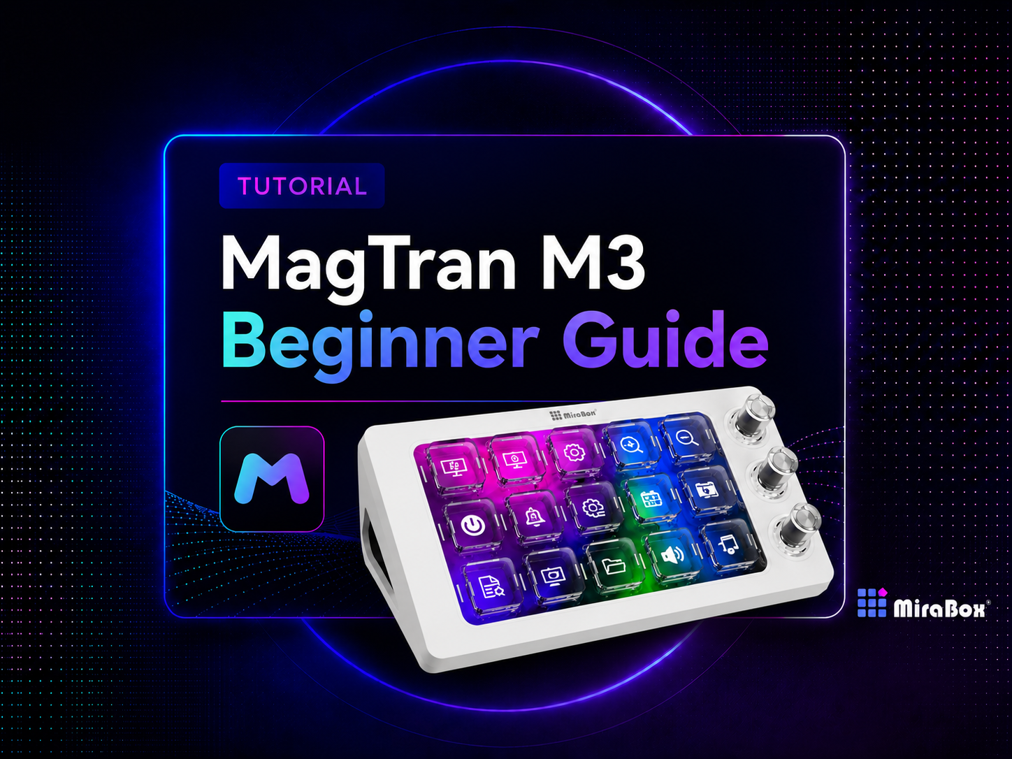

Set Up and Use StreamDock M3
Beginner Quick Start Guide for Magnetic Keys, Dynamic Backgrounds, and Interactive Features
The MagTran M3 is not just another stream deck alternative or macro keyboard.
It introduces:
  • Magnetic trigger technology
  • Interactive backgrounds
  • Dynamic screen savers
  • Per-key visual effects
  • Mini games
  • Advanced creator workflows
This beginner guide focuses specifically on the unique features of the MagTran M3 and explains how to get started quickly.
